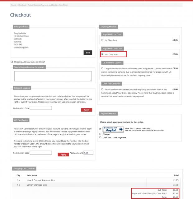

    I've set this up on a clone of my main site and everything is working well with the add-on installed. I have tested it with the PayPal Express (sandbox), COD and moneyorder payment modules and all of them work.
    The only minor point I noticed is that the checkout page selects the cheapest non-free postage however the order total shown at the bottom of the page doesn't include the postage unless the radio button is clicked again or a different postage option is selected. I use a cloned table shipping module and the default being selected by the checkout page in my case is table2 (UK 2nd class postage). The correct order total still goes through when the order is confirmed however I wondered if there is some way to get the page to refresh the total when the default is selected by the checkout page or if it is possible to have no postage selected so that the customer needs to pick from the list?
    I've attached a screen shot of the page in use on my test site.

    Gary, since you've got the plugin installed on a clone (so you're the only customer accessing that "clone"), you could create me a debug-file and send it to me via PM.
    It's important to note at which point the shipping doesn't get included in the total. Is it the very first time you "hit" the checkout_one page after you've logged in? I'm "assuming so", so:
    1. Log off of the store front.
    2. Log into your admin and set the One Page Checkout Settings, Debug to true.
    3. Sign back into your storefront, place a product in your cart and click the Checkout button.
    Does the symptom display itself at this point (i.e. no shipping selected)? If so, look in your store's /logs folder for a file named myDebug-one_page_checkout-xxx.log (the xxx is your customer_id), make a copy and PM that to me.

    Thanks for your reply. Yes it happens either when I'm logged in and first click checkout or click checkout and then login. The radio button for 2nd class post is already selected and the sub-total and shipping are both show at the bottom of the page above the confirm order button, however the total shows the same amount as the sub-total (i.e. the shipping isn't added). I'll PM you the log file created at this stage. It's not a major problem and the total does go through once the order is confirmed.
