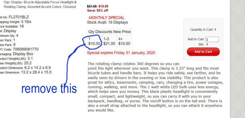

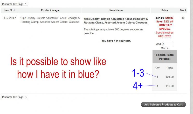

    Just need two small changes in the product listing page and product info page. I have two jpegs attached to show the change I am trying to make

    The code I have for in modules/product_listing is
    $products_id = (int)$listing->fields['products_id'];
    $getQD = ("select products_id, discount_id, discount_qty, discount_price from " . TABLE_PRODUCTS_DISCOUNT_QUANTITY . " where products_id = $products_id");
    $displayQD = $db->Execute($getQD);
    if(
    $displayQD->RecordCount() > 0) {
    $lc_text .= '<table style="border:1px solid #E9E9E9" cellspacing="0" cellpadding="3">';
    $lc_text .= '<tr style="background: #C0C0C0; font-weight: bold"><td colspan="2"><strong>'.TEXT_PL_QD_HEADING.'</strong></td></tr>';
    $lc_text .= '<tr style="background: #F5F5F5;">';
    $lc_text .= '<td>' . TEXT_PL_QD_QTY . '</td>';
    $lc_text .= '<td>' . TEXT_PL_QD_PRICE . '</td></tr>';
    while (!
    $displayQD->EOF){
    $lc_text .= '<td>' . $displayQD->fields['discount_qty'] . '</td>';
    $lc_text .= '<td>' . TEXT_PL_QD_DOLLAR . number_format($displayQD->fields['discount_price'], 2, '.', '');
    $lc_text .= '</td></tr>';
    $displayQD->MoveNext();
    $lc_text .= '</table>';
    How to change the code to show
    1-3 $21
    4+ $10

    From the product info page how do I remove the quantity 1 $10.
    only show
    1-3 $21
    4+ $10
