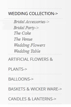

    I've taken on a new project, or rather we're expanding our floristry webiste into a new, wholesale website at www.silkblooms.co.uk/wholesale. I've decided to opt for a new Template Monster 1.5x template this time but I can forsee some problems with the category tree as it's been coded for top level and one sub level category only. Unfortunately, our new site will have top level and then two sub levels so it's acting quite strangely. Can you take a look at the Template Monster demo, then compare it to what we're getting so far:
    http://www.templatemonster.com/demo/38409.html
    V
    http://www.silkblooms.co.uk/wholesal...ain_page=index
    Do you think it'd be better to install Categories Dressing in place of the category tree from the templeate? Will it be easy to implement so that the categories look and behanve the way they should, rather than the way they're behaving now?
    Click on the "Wedding Collection" category and we'd like it to be more like this:
    At the moment, it's like this:

    I didn't see the way your site was behaving before you installed Categories Dressing on it, so there's not much to say about your initial questions. You certainly can style subcats as desired, with what you already know about Cat Dressing.

    I reckoned the easiest way was to install Categories Dressing as the template category tree would have probably needed re-writing. So, I'm trying to make it look like this:
    This is the first I've used the latest version of Categories Dressing. For the life of me can'tfigure out how to remove the hover background image or the heading that says, "Cat 3 Sample".... I'm sure it'll tell me in this thread somewhere... I'll have a look.

    That was easy :) I've removed the headings and the backgrounds colours and borders.... Now I just need to figure out the indents. They seems to be quite large.... Where should I be looking to make the indents much lower?
    Also, how would I add a dotted line to seperate all the top level categories, similar to the template file?

    limelites - The subcats have margins and padding on the left which can be adjusted in the stylesheet, for example:
    stylesheet_categories_dressing.css (line 93)#categories ul ul {/*subcategory lists*/
    list-style: none;
    /* background: #ffeecc;*/
    border: none;
    margin: 0 0 0.7em 0;
    padding: 0 0 0 0.8em;
    and under
    #categories ul {/*top category lists*/
    You may also have had the default Zen Cart subcat indent spacing active; if so, it seems you have now eliminated that.
    Dotted lines separating top cats would best be done with something like
    border-top: 1px dotted #aabbcc;
    in the
    #categories ul a {/*top categories*/
    rule.
    Category menus that expand and contract on clicking can only be done with javascript ("accordion menu"). This would have to be a completely different set of code.

    I have a few questions/issues but let's deal with them one at a time. RE the dotted lines to seperate top level categories, I can't seem to get this one. Here's the css in stylesheet_categories_dressing.css:
    display: list-item;
    list-style: disc inside url(../images/bullet1.gif);/*change to list-style: none; to remove bullet*/
    background: no-repeat;
    /*border: none;*/
    margin: 0;
    padding: 0;
    background:none;
    font-family:"Times New Roman", Times, serif;
    font-size: 1.0em;
    text-transform:none;
    ...... it seems to have no effect.

    Got the dotted lines working... I'm being really picky here but is there a way to increase the distance between dots? Also, is there a way to remove the top one from above the "Wedding Collection" category?
