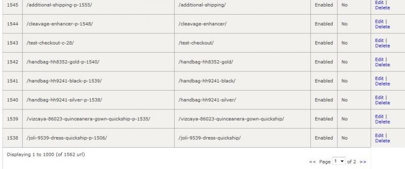

I recently upgraded to Zencart 1.5.1 and my brother (SPH) installed the SSU Manager. It appearerd to be working well until we saw that the pages suddently disappeared from the Manage Aliases page. It should have shown 77+ pages and was only showing 2 pages.
We figured out that if we just changed the url to a high page number in the browser, we could page through at that point.
https://www.promstobeaches.com/admin...s.php?page=200
So we did a reinstall and started over. It seemed OK for a while until the pages disappeared again. At first was able to adjust the browser url to page through the category and product listings but now that does not even work. So I have no way of paging through to see all of the pages, except for 2 pages.
Then, I noticed that after I uploaded a test product, the total number of urls showing at the bottom of SSU Manager did not increase by 1. I assume it should have shown up at the top of the first page of the manager as the latest ID. I thought it might take a while to appear but it still has not and I did this yesterday.

I have updated the new version and fix your problem. If it works fine for you, please write a review. Thanks.
