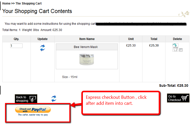

Here is the screen shot of my site express checkout button screen.
Attachment 14922

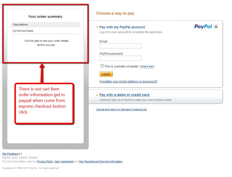

After click on checkout button it will redirect to Paypal screen as below , but not take cart item information with Paypal It is display blank in Paypal screen as below.
Attachment 14923

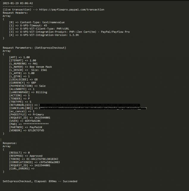

Yes , I have check log file , there is not any error in that , whole Request Headers, Request Parameters and Response array are printed with Approved status. check below log file screenshot.
Attachment 14927
