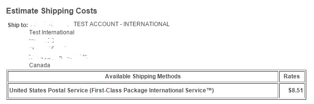

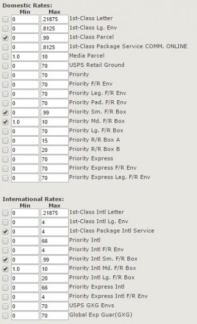

I installed it and everything but priority international works for me.
Domestic orders show an option for the customer to choose first class or priority.
International shows an option for first class only.
I have priority set up the same for both domestic and international.
I am using 1.5.4
Attachment 15961
Attachment 15962
Re: USPS January 17, 2016 K8 BETA TEST SERVER ONLY
Turn on the Debug to Log and try your quote again ... then Zip the shipping log that is created in the /logs directory and post it on your reply ...
