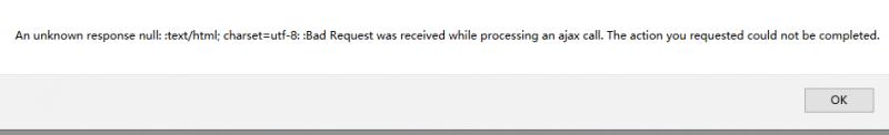

An unknown response null: :text/html; charset=utf-8: :Bad Request was received
An unknown response null: :text/html; charset=utf-8: :Bad Request was received while processing an ajax call. The action you requested could not be completed
I am desperate,when visitor login and click checkout or go to shopping cart,it will pop-up this message,someone please help,i don't know what's going on,thanks.:no:
Re: Bad Request was received while processing an ajax call. The action you requested
Attachment 16848
Here is a screenshot

I have found the problem,i am using a westminster_new template,there is a jscript_framework.php in jscript folder,after i delete,the problem won't be there,i am wondering what's going on with this file.

Yes, that's your problem.
If you want to use that template on v1.5.5 you will need the v1.5.5 version of the jscript_framework.php file.
