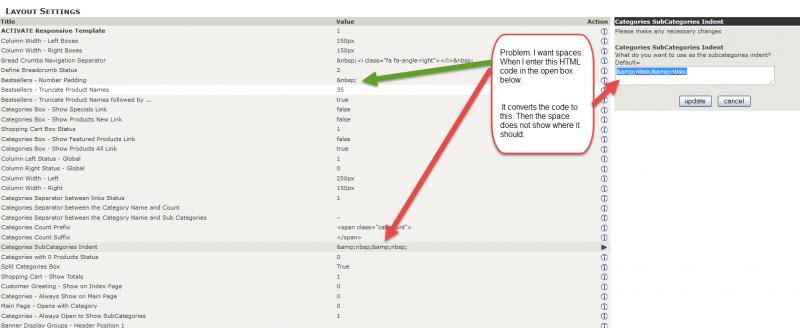

I am trying to add spaces to my layout setting area (Categories SubCategories Indent and another field on this page). Obviously I should be able to add this to the field: or this for a double space: and save right? Pretty simple in the past.
These areas did haves the space entered as default but I removed them during some testing. Now I want them back. When I add this coding to this admin area and save it creates this:
and no spaces happen where they should.
It won't let me put the standard coding in the field it converts the & symbol to the html version. And it does not add the space if I put the cursor in the box and hit the space bar then save. It just stays blank. This seems like a bug to me. How can I enter the space coding and have it properly convert? Never had this before something is funny.
See attached image below please.

I tried your suggestion the issue still persist. It still converts the ampersand even with the escape.

Thank you Gilby the solution you provided worked! I did perform a search before asking this question but for some reason just did not find the answer you provided. Anyway, I appreciate your help!
