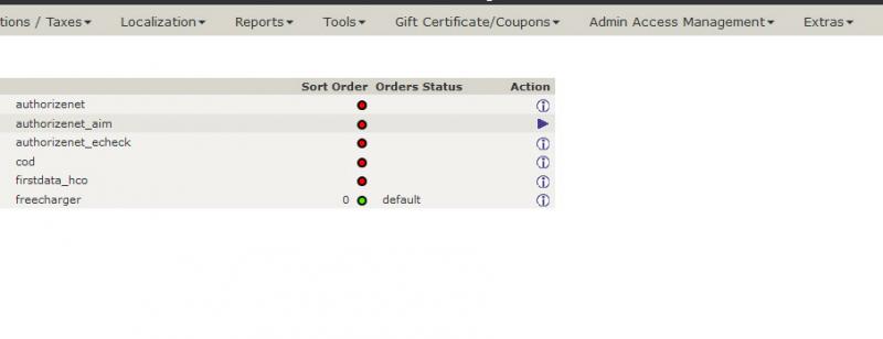

New install. I am trying to access the authorize.net (AIM) section of the payment modules in admin and none of the boxes are populating on the right hand side where the normal install / edit etc would be. Attached is a screenshot. How do I get this fixed? What page should I overwrite etc?

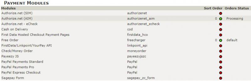

Or can you at least post another screenshot of the list of payment modules as they show "now"? ... cuz it's the one after FreeCharger that has an incompatibility in it ... ;)

Is this what you're looking for?

Yes, that was what we were both asking about.
The linkpoint API payment method has been retired/replaced by the payeezy method. In your "upgrade", its files were not removed from your site, and (because its code is old and no longer supported) leaving it there causes an issue with php 7.x.
It would be recommended to at least remove that file from loading from the includes/modules/payment directory and for "cleanliness" to remove it, it's sub-folder and the associated language file... then you should be able to again operate under php 7.x as supported by the remainder of software on your website.

Additionally, the "rest of the page" isn't being drawn, after the Sagepay module, so that means a PHP error has been triggered. And its description should be in your logs directory as /logs/myDebug-adm-xxxxxxx.log files.
