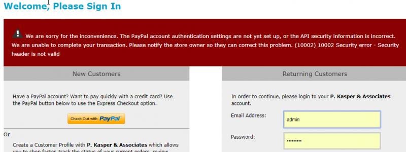

But when checking out, there is a red box that appears: "We are sorry for the incovenience. The Paypal account authentication settings are not yet set up, or the API security information is incorrect."

I have SSL installed on pkasperassociates.com, including pkasperassociates.com/classes (the store page). API and IPN are done on paypal site. I am still getting the attached error snapshot. Any ideas?
karineAttachment 17957

Review your API information for a sixth time. As said elsewhere in this forum, you can add an extra space or delete a character. and when you come back to view your payment module, things can alter. In my case, the API signature-username appeared twice, so when I did one of my redos, although I had a blank text field, the former username was there but not visible. It was only when I left the payment module and returned back to it later for another try that the double username appeared.
When I called PayPal web services tech support (they are very helpful), they said the "Error 10002 Security header is not valid" is always an API information issue. Something has been incorrectly typed.
