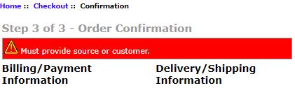

I had Stripe installed for 1.52 on a site.
I updated to ZenCart 1.65 last Thursday, then 1.65a on Monday when the cart posted update available.
I did the reinstall and put the Stripe settings like they were, as it worked earlier.
In either case (1.56 & 1.56a) I get an error message with the last version available that's for Stripe payment for verson 1.55. It says: "Must provide source or customer", so credit card charges are not accepted. What needs to be done to fix this?

ZenCart 1.65a Problems with Stripe Payment Module
I had Stripe Payment module installed for 1.52 on a non-profit site. I updated to ZenCart 1.65 last week Thursday, then 1.65a on this Monday when the ZenCart Admin area posted update available for 1.65a. I did the install for Stripe Payment in ZenCart 1.65 and had the following problem. Then I reinstalled in ZenCart 1.65a and put the Stripe settings in each, like they were as it worked earlier in 1.52.
In either case (1.56 & 1.56a) I get an error message with the last version available that's for Stripe payment for ZenCart versons of 1.55. It says: "Must provide source or customer", so credit card charges are not accepted or allowed to go through. What needs to be done to fix this? Will this module be updated soon, as right now this non-profits shopping cart is unable to accept Credit Card payments via Stripe since it's new updates.

Thank you for your reply. The webhost has PHP 7.1 as highest version, that is what it is current set too. The shopping cart is working well with PayPal Standard. The current Stripe module available in Plug-ins was installed after 1.56, and again reinstalled for 1.56a, and this issue is the same for both, "Must provide source or customer" when a credit card is submitted. Yes it does it in test mode and also when not in test mode, in both versions 1.56/1.56a. There is no errors concerning this in the webhost error file, so I would think the problem is not likely PHP at the webhost end of it.

Searching on the internet for that particular error message has identified a number of possible causes, but it seems to do with stripe not receiving all of the applicable information to be able to provide back a positive response.
So, that would lead me to look at the process of developing the current site and how it is different from a brand new new unaltered site. Further would encourage reviewing the credentials entered to support the operation and verifying that those for test were only used for test and those for production only for production, if there is some difference between the two conditions
I mean, one individual reported that their problem was fixed by including a call to implement jQuery on a page. While I doubt that would specifically be the problem using a default install with the built-in (unmodified) templates, it's important to first check the basics (again?). :)
