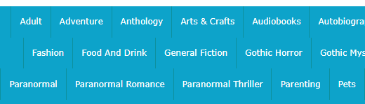

I have a list of Top-Level Categories at the top of each page:
Attachment 18313
Clicking on 'Adult' takes me to http://digibooks.org.uk/db_155/index...index&cPath=31 (Adult has the categories_id of 31)

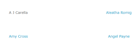

This gives me a list of Authors under Top-Level category Adult:
Attachment 18314

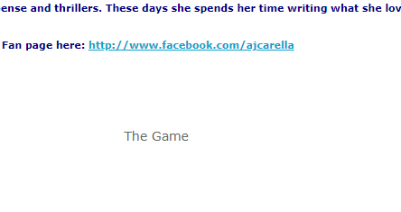

Clicking on 'A J Carella' takes me to http://digibooks.org.uk/db_155/index...x&cPath=31_589 (where A J Carella is sub-catory 589)

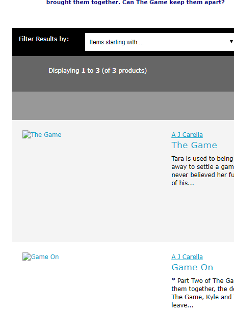

A J Carella has one series so clicking on that takes me to http://digibooks.org.uk/db_155/index...ath=31_589_590 (The Game Series)
Attachment 18315
Attachment 18316
The first Book 'The Game' links to http://digibooks.org.uk/db_155/index...oducts_id=6377 and so on.
