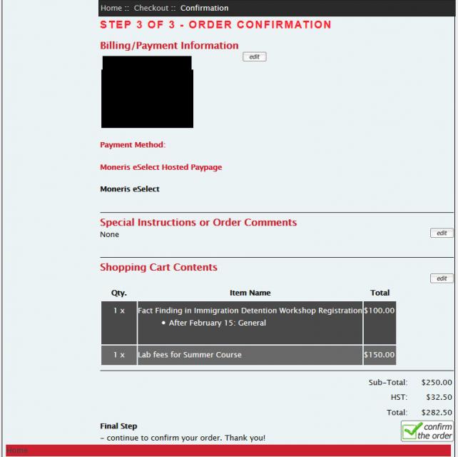

We're using ZenCart ( v1.5.5e) with a Moneris hosted paypage: https://crscom.apps01.yorku.ca/ec/in...ain_page=index. I am having difficulties in displaying the HST charges on the Moneris Hosted Paypage response/receipt (attached). The HST is being correctly charged, but the amount doesn’t display in the item details. In ZenCart, the HST is correctly calculated and displayed, but when the purchaser clicks on the “Confirm the order” link and is directed to the Moneris pay page, the HST amount disappears (attached). I don’t know if this is a problem at the Moneris end, or the ZenCart end. I tried looking at https://developer.moneris.com and found some coding, but have no idea where it’s supposed to go. Unfortunately, we no longer have a technical support person to assist us, so I was hoping you might be able to provide some advice/instructions.
Attachment 18888Attachment 18889
Any advice would be greatly appreciated, thanks.

Thanks - the coding can be found here: https://developer.moneris.com/Docume...Payment%20Page
<!--The code below will set the cust_id, order_id, and the lang as well as add gst, pst, hst and shipping cost details for display in the receipt.-->
<input type="hidden" name="cust_id" VALUE="invoice: 123456-12-1">
<input type="hidden" name="order_id" VALUE="oid43333">
<input type="hidden" name="lang" VALUE="fr-ca">
<input type="hidden" name="gst" VALUE="0.80">
<input type="hidden" name="pst" VALUE="0.70">
<input type="hidden" name="hst" VALUE="1.50">
<input type="hidden" name="shipping_cost" VALUE="4.99">
<INPUT TYPE="hidden" name="eci" VALUE="1">
Re: Problem in displaying HST in Hosted Paypage emailed response/receipt, using ZenCa
While I'm not familiar with the Moneris payment plugin for Zen Cart, it does look to be entirely on Moneris's end. I would pose the same question and screenshots above to Moneris support.
Obviously after you've checked that the plugin is sending and receiving what it is supposed to, which sounds like it is since final charges are all correct.
