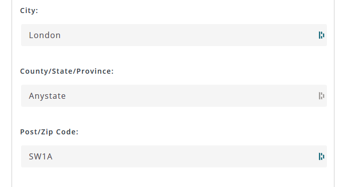

index.php?main_page=create_account, my fields look like this:
Attachment 19272

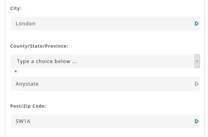

If I submit the page without ticking the privacy statement box, on refresh the fields look like this:
Attachment 19273
You can see that the state dropdown has been incorrectly added. Note: I'm using United Kingdom as the country without any zones defined in Locations / Taxes > Zones.
Re: State dropdown added to create account page erroneously
This is actually "somewhat" by design. If you were to change your selected country (in the countries dropdown) then the State dropdown would fill with zones appropriate to the selected country. When selecting a country without zones the dropdown says "Please type a choice below..." by way of instruction.
Granted, there does appear to be a layout issue with the fields after toggling between countries with and without zones defined.
NOTE: The "trigger" for this is not related to the "privacy/terms checkbox", except insomuch as, as you said, you failed to tick the checkbox thus it failed validation. Any other validation failure (such as duplicated email address, etc) would trigger a similar display.
And, yes, an improvement would be to auto-hide the State dropdown when it's empty, and then re-display it again if the country choice requires it. Indeed I think that's the original intention, but seems to not be operating fully that way in v157.
