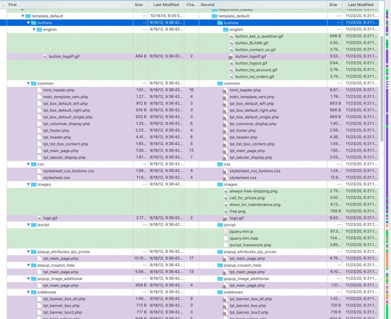

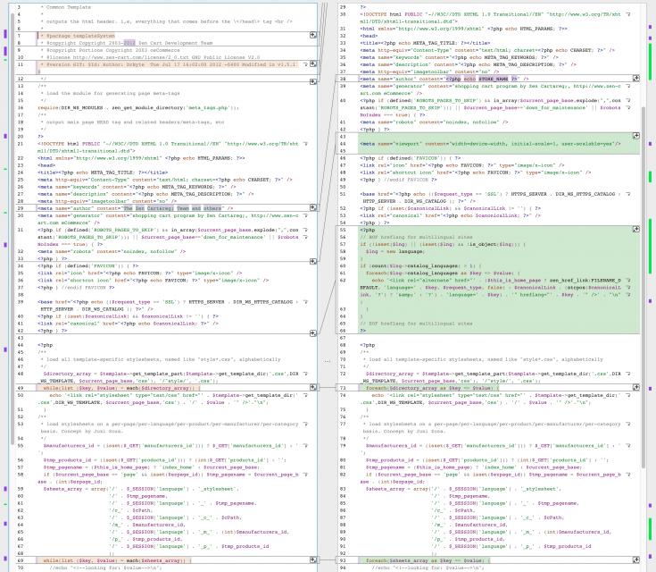

Here, I'll start. I'm using a program here that's very similar to WinMerge in what it does so while the style of display will be different, it is the same in the fact that it shows rows of files that are different between selected directories, and within files it shows exactly what's different between them.
These two images are a comparison of /includes/templates/template_default between v151 and v157. The first is a partial list of changed files (with identical files excluded), and then the top portion of the html_header.php file.
How is yours different?
Attachment 19301 Attachment 19302
