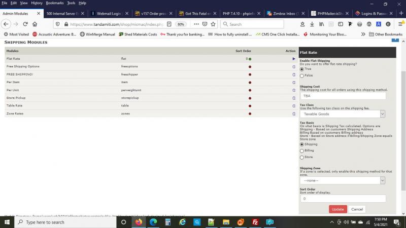

Would you post a screenshot of the flat-rate shipping's setup in the admin's Modules->Shipping?

Here is the scree shot.
Attachment 19548
Re: Order process stops at final step
earthspark
[04-May-2021 11:44:00 America/New_York] PHP Fatal error: Uncaught Error: Call to undefined function PHPMailer\PHPMailer\ctype_alnum() in /******/includes/classes/vendors/PHPMailer/src/PHPMailer.php:1791
This is the culprit. I suggest you check your php settings to see if ctype extension is enabled. You can go to admin->Tools->Server/Version Info and simply search that page for "ctype" to see if the extension if enabled. If it's not, contact your host to enable it for you. I don't recall seeing it in cPanel's PHP Extensions page, nor in Plesk.

For those pesky PHP Warnings, those are due to your setting of TBA (a non-numeric value) for the Flat-rate shipping's cost.
