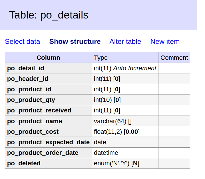

you really need a PO type of system. which would involve a number of tables such as:
Attachment 19603
an example of the po_details table:
Attachment 19604
and then you would need some code to input this table. and it all should tie to your products table.

carlwhat
Attachment 19603
Attachment 19604
i have done this before for clients, but it is not packaged up as a plug-in.
best.
This is the sort of approach I was thinking might at one time help... This I will have to give some thought. I suppose on easypopulate import, the added quantity could be added to what's there?
