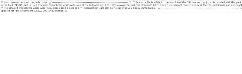

When printing from the admin side for either a packing list or invoice I am getting wording at the top, how can this be removed? Attachment 19752

Have you had any modifications done to your store? as normally you don't get such issue.

you look to have some remnant of this module here:
https://www.zen-cart.com/downloads.p...1642&styleid=2
https://github.com/dbltoe/PDF-Attach...ct-Description
the text looks to be echoed from here:
https://github.com/dbltoe/PDF-Attach..._functions.php
i would look to uninstall that module and remove said files or correct the install. it "might" be that the file is missing <*php on the first line.
best.

Yep, you need to get the latest version and overwrite the YOUR_ADMIN/includes/functions/extra_functons/pdf_attachments_functions.php file.

Thank you all, uninstalling and reinstalling to the 2.2.1v solved the header issue. Again, Much appreciated. Have a great day.
