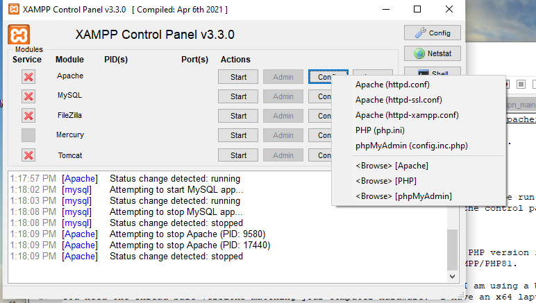

Save the php.ini file. - Launch XAMPP Control Panel as Administrator.
- Click "Configure" and you get the screen below so that we can configure Apache.
Attachment 20025
When clicking on these, Notepad will open the file for editing. Following the instructions from

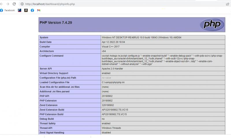

For my base install, no port is specified
Attachment 20026

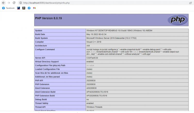

for PHP 8.0, specify Port 8080 ie localhost:8080
Attachment 20027

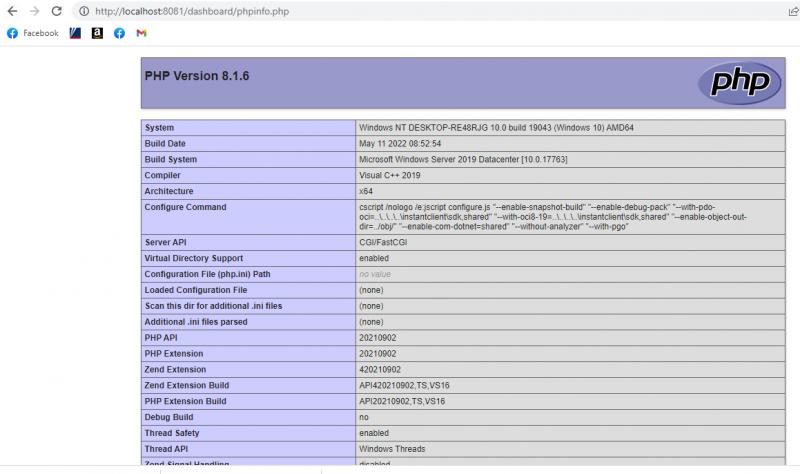

for PHP 8.1, specify Port 8081 ie localhost:8081
Attachment 20028
