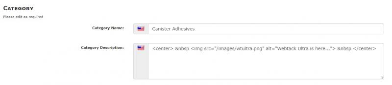

If I remember correctly, the image is removed from the category description unless the   is used.
Re: Category description image disappears
Screenshot for clarity, yes it is in the category description box.
CunningStunt2
Attachment 20141
Well, aren't you just the "Cunning" one....lol.
That did the trick.
Really strange though because I have tons of others that do not use the   and they still show up.

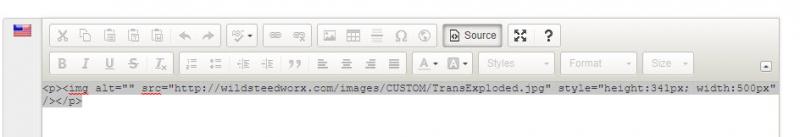

For example the "Transmission Assembly" Category image shows up and it looks like this:
Attachment 20144
