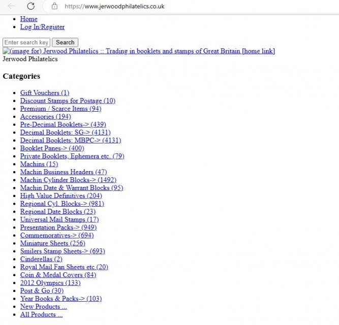

It broke the storefront not the admin side. The storefront wound up looking like the attached image:
Attachment 20387
Thank you in advance, George

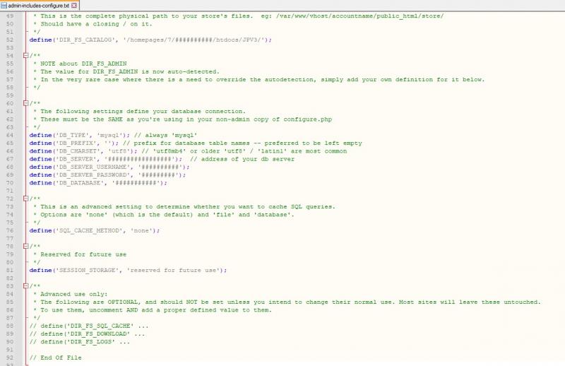

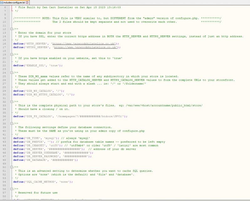

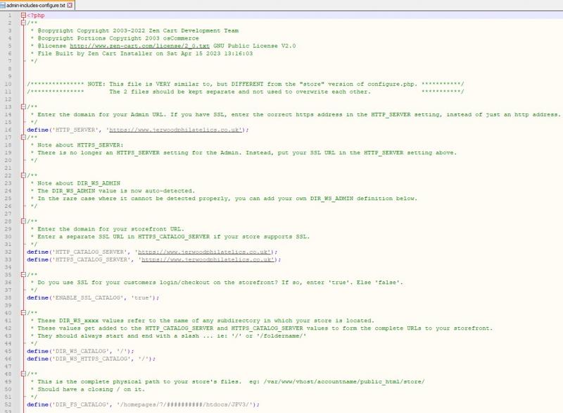

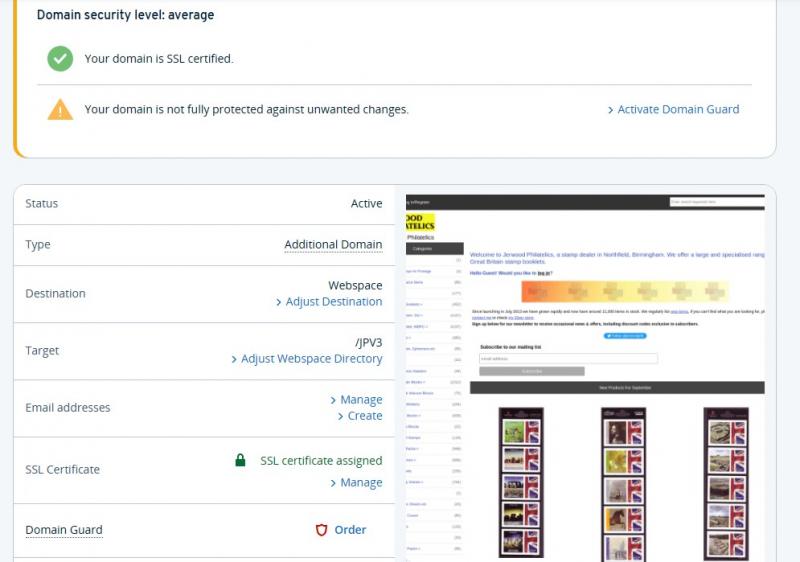

Hi, huge thank you to dbltoe and mprough, I do appreciate your time/help. I am still puzzled though, sorry. I have told Ionos (formerly 1and1) to point to the folder where ZC is via the settings/options they have, please see the attached image, the Destination is my webspace (which i believe is referenced in the FS in the config) and the Target is the correct folder, is this the same as a 301 redirect or do i still need to do that? Please see image, hopefully it will make sense.
I have also attached images of the two config files, editing out the specifics as per previous instructions (hopefully), i am hoping this makes it a little easier to see what is going on. I believe the FS values are set correctly, the WS part is the bit that breaks if i update it to reference the folder.
The store definitely is in a folder, the folder does not ever show when a product is accessed, or added to the cart.
Further advice based on my config files would be greatly appreciated, thank you in advance, George
Attachment 20390
Attachment 20391
Attachment 20392
Attachment 20393

admin/includes/
define('DIR_WS_CATALOG', '/JPV3/');
define('DIR_WS_HTTPS_CATALOG', '/JPV3/');
includes/
IF it is genuinely in a folder in the public root.
Otherwise, if it's not...
admin/includes/
define('DIR_FS_CATALOG', '/homepages/7/######/htdocs/JPV3/');
includes/
I'm still not understanding why the redirect. The site is indexed without the folder. Was the store always in the folder? It just doesn't make any sense =(
~Melanie
Re: Runing Zen cart site in a folder
Perhaps there's an .htaccess ReWrite to send root-directory accesses to that sub-directory.
This statement implies to me that the configure files do not match.
So if Lat is right and they configured your public root to be /JPV3/ then BOTH configure files would be like so.
admin/includes/
admin/includes/
includes/
includes/
It would also mean that your issues with the Square plugin are not related to this. Also your SSL is fine, so that doesn't look to be the issue.
Do you have the exact error message you received from the plugin?
Can you contact your host and get the rundown of this folder? Specifically whether it's your public root or not.
