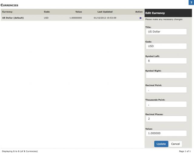

I have that set at 2 decimals. Should it be set at 0?
Attachment 20431

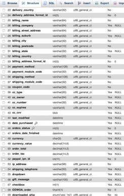

Old database that was running 1.5.4 had the field order-total's 'value' field set to 2-digit decimal.

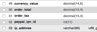

The new database in 1.5.7 has the order-total's 'value' field set to 4 digit decimal.
Attachment 20434

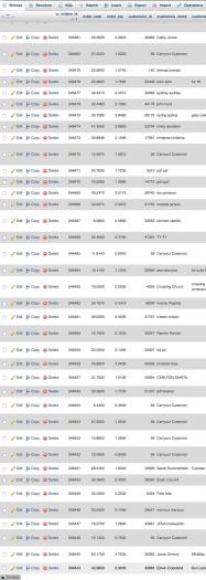

which is causing issues in the database...
Attachment 20437
because when we return information from that table's field it is now not in US dollars but in fractions to the ten thousandths of a dollar.
As posted in a previous comment, the Admin>Localization>currencies is set to 2 decimals.
Attachment 20436
