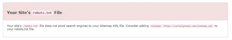

ONE other thing... I'm using the Sitemap XML v4.0.1 plugin and see this advice:
Attachment 20663
However, a simple URL check demonstrates that the file is right there. Should I just ignore the warning? Why do these things happen? :)

SitemapXMP uses this concatenation to determine the presumed means to access a site's sitemap.xml file:
HTTP_CATALOG_SERVER . DIR_WS_CATALOG . SITEMAPXML_SITEMAPINDEX . '.xml';
... where the first two constants come from your admin/includes/configure.php and the last one is set in the SitemapXML configuration settings. From viewing the robots.txt, that contains a www. prefix to the site's URL which is not reflected in the HTTP_CATALOG_SERVER setting.
Sitemap: https://www.usrallyteam.com/sitemap.xml

I thank you for the help, lat9. In plain English, then... What you're saying is that a simple change will fix the problem, yes?
I should rewrite this:
to this?
Sitemap: https://usrallyteam.com/sitemap.xml

Yes, sorry for not stating the actual solution from the get-go!
