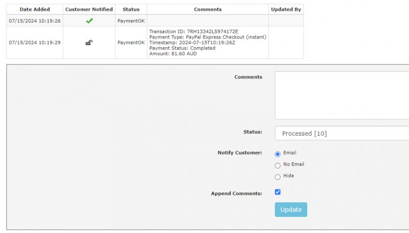

Got a fairly vanilla version of 1.5.8 where for the last day or so, when I update orders in the actual order page I get the message "Warning: Nothing to change. The order was not updated." after changing from Pending to Processed and hitting update. There is also no message that the email has been sent.
After the order reloads, the status in the pulldown box (and also on the main orders list page) is showing as processed but the update hasn't been added to the comments list.
Attachment 20704

It seems to be behaving itself at the moment, and the server load is lower, so I suspect the server was the issue.
