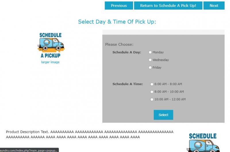

I have a product with attributes. The issue I have the the product description is below the product and attributes, not above it.
Attachment 20784
Is this correct? How do I get the product description above the product and attributes?
Attachment 20784
If you take a look at your includes/templates/custom/template/tpl_product_info_display.php and find this code...
<?php } ?>
Take all of that code and place it just below this code (which is near the top of the file)...
<!--bof Product Name-->
<!--eof Product Name-->
It will place your product description just under the product name....then all of your attributes, product image, etc. will be below your product description.
You can move the Product Description code anywhere in this file and it will change its position on your page.
Hope I understood your question correctly to give you what you wanted.
