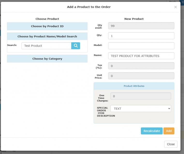

When I open the invoice on the Admin side, open EO, click "Edit" next to the line item I can see the attributes for the line item that was entered on the store side.
But again, if I click on "Add Product" the "Add a Product to the Order" dialog opens but no attributes are displayed.
Attachment 20910
If I change the "Option Type" to any of the other types i.e. "Drop Down" then the attribute will show up. I don't recreate the invoice or anything. I just go into Option Name Manager and change the "Option Type" to "Drop Down" and then the attributes will show up in EO.

However, in doing so it has generated a new issue where the attribute selection will not show up if you use the "Add Product" button in EO.
If you add the "Special Order" item via the store then access that line item via the "Edit" button in EO you can see the items attributes.
If you use the "Add Product" button in EO, select that item in the search box and click "Choose" you can't see the items attributes for entry.
If I change the attribute to any other Option Type i.e. "drop down" and then use the "Add Product" button the items attributes will then appear.

I accessed the invoice on the admin side as seen below:
Attachment 20914
I then go to "Option Value Manager" access the "SPECIAL ORDER ITEM DESCRIPTION", click edit and change the "Option Type" to File. I go back to the invoice that was created and find the attribute change is now reflected on the invoice line items that have already been committed as seen below:
Attachment 20916
I would expect the code that sets up the invoice interface would pull line-item data from an order database table and the option value type id would be stored against that invoice's id number, correct?
