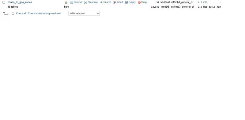

when you have your database open in phpmyadmin, scroll to the bottom, and there is the check all to select all tables in your database and then the dropdown is right next to that
Attachment 20938
Re: Problem changing all DB collations to utf8mb3_general_ci
Ok thanks barco
I ran Analyse selected (all) and the reply was "Table is already up to date" in every case.
However, structure tab lists mix latin1/ utf8mb3 / utf8mb4 ?
well, that confirms that the "convert_database.php" didn't do the conversion.
