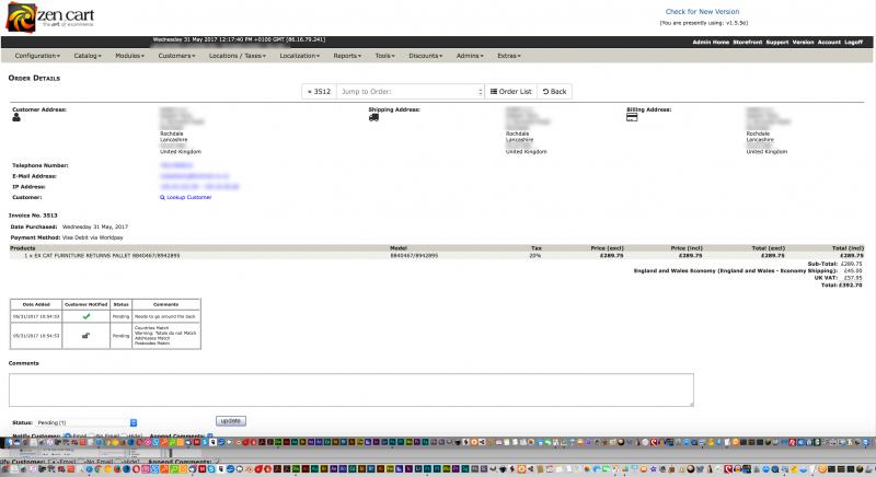

Ok if you look further up I have supplied screenshots you can download of how shipping, countries, zones, VAT etc is set up.
You can get them here https://www.ventureonlineuk.co.uk/screenshots.zip
I've attached a further screenshot of the admin after the order, get your calculator out and you will see its not adding VAT to the shipping cost.
What does the order confirmation show? The order confirmation email shows the same as what appears in the admin.
What is the result in the various locations within the admin where the issue seems to appear? There's only one location and that is Customers > Orders
During the checkout process where does the "calculation" appear incorrectly? No it doesn't appear incorrectly, and the customer pays the 'cost of the product + VAT' and 'cost of shipping + VAT' NOT 'cost of the product + VAT' and 'cost of shipping - no VAT'
What payment module(s) are involved? - Worldpay V.3.0
How has the store been otherwise modified or amplified (what files have been added or attempted to be renamed)? - none that would affect the checkout process, and before you jump on this, I cannot give you a run down of every single file that has been changed, but I do know none of them would affect the checkout process since nothing has been changed there.
So yes, had reviewed all of the images which generally showed "everything" but certainly made it difficult to identify if there was a difference that caused an issue... I.e. a sample of one "set" would have been sufficient if all testing indicated that all of the others experienced the same problem.
Now that said and in line with other communication in this thread, note the above quoted post. It specifically relates to Worldpay and does not involve the checkout_X files that supposedly have been changed away from the ZC 1.5.5 version of the sequence.
So what does your wp_checkout_process.php file look like? (Found in includes/modules/wp_checkout_process.php)

Further, to confirm that this is in fact a result of the payment module, if you were temporarily enable say check/money order and perform a checkout using that payment method and confirm that the results are as expected/desired it would identify that the payment method is at play (which bottyz already has confirmed).

I'd already moved it, like this, and missed the bit about Worldpay so my apologies if I missed that in reading.

require(DIR_WS_CLASSES . 'order_total.php');
$order_total_modules = new order_total;
$order_total_modules->collect_posts();
$order_total_modules->pre_confirmation_check();
// load the selected payment module
require(DIR_WS_CLASSES . 'payment.php');
Notice the sequence: order, shipping, payment... This is still different as compared to a fresh install of WorldPay V3.0 as downloaded from the website which has it as: payment, shipping, order.
So actually looks like includes/modules/wp_checkout_process.php in this area should be changed from:
// load selected payment module
// $payment_modules = new payment($_SESSION['payment']);
$payment_modules = new payment('worldpay');
// load the selected shipping module
require(DIR_WS_CLASSES . 'shipping.php');
$shipping_modules = new shipping($_SESSION['shipping']);
require(DIR_WS_CLASSES . 'order.php');
$order = new order;
possibly to:
$order = new order;
And maybe even include order totals type code moving to after the shipping code and before the payment code.
Well after changing that code, an order came through and the callback failed.
