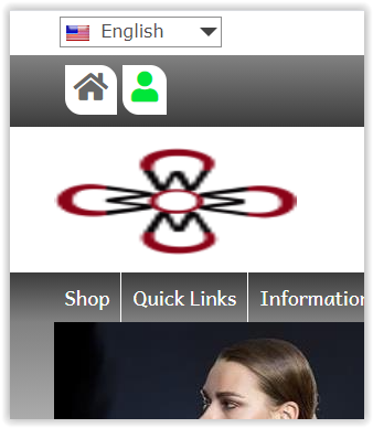

No matter how I try to configure this logo, it comes out distorted. The orginal is a png 250x250. I have tried resizing and all but no matter what I do its still zoomed/stretched....any thoughts?
found it...includes/templates/fluorspar/css/stylesheet.css
its a fixed item on line 36 #logo img{width:220px;height:97px;}
