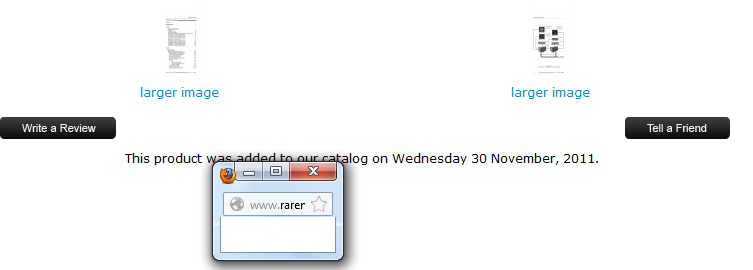

Hi guys
two questions :)
What is the best size image to upload for IH3 , currently I'm using 800x600 jpeg . What would be optimal for IH3 ?
Also when I click on 'Larger Image' a browser window opens but it is very small. I have included a picture below . Is there anyway I can change it to open a larger popup ?
Thanks Paul
Attachment 11914

You can upload any size you like.. the issue with your popup looks like an installation issue..

I had problems like that with 1.37 and fixed it with the stylesheet but I surely can not remember what I changed, sorry
but on the other hand you could install zen_lightbox and not worry about that...lol it works great with IH3 especially if you have additional images too

The small popup still points to an install issue and it's unlikely it's an issue with the stylesheet. I would bet there are errors in the error log which are causing the popup to fail to render correctly..
