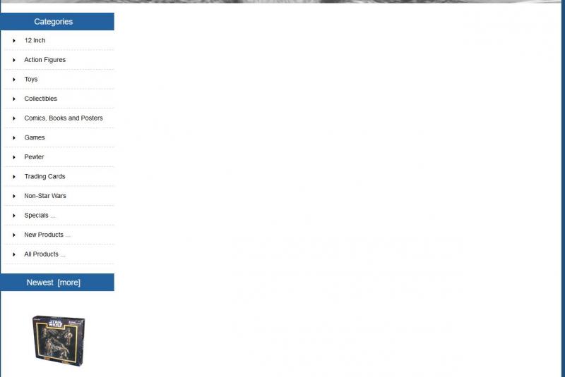

I made the first changes to includes\templates\responsive_sheffield_blue\templates\tpl_index_default.php (See below code that I changed) I changed the tpl_modules_featured_products.php file to have a value of <section id="section-2"> and I changed file tpl_modules_whats_new to have a <section id="section-1">
See my screen print below. Now everything is gone except for what is in column 1. Even the footer area is gone.
Below is the change I made to tpl_index_default.php
Made this change at the very top of the code:
* Modified by Anne (Picaflor-Azul.com) Responsive Sheffield Blue v1.0 v2.0
include(DIR_WS_MODULES . zen_get_module_directory(FILENAME_NEW_PRODUCTS));// added jpda
include(DIR_WS_MODULES . zen_get_module_directory(FILENAME_FEATURED_PRODUCTS_MODULE)); // added jpda
include(DIR_WS_MODULES . zen_get_module_directory(FILENAME_SPECIALS_INDEX));// added jpda

What it looks like now:
Attachment 16496
What you have there is a blank or partial blank page... That means something was done or is being done incorrectly, error log should be waiting for you in the logs directory.

I figured it out. it was the */ after the include statements. I removed it and it started working.
Thanks for all your help.
also thanks for the tip on how to add code to the forum. I always wanted to know how to post the code in those boxes.
