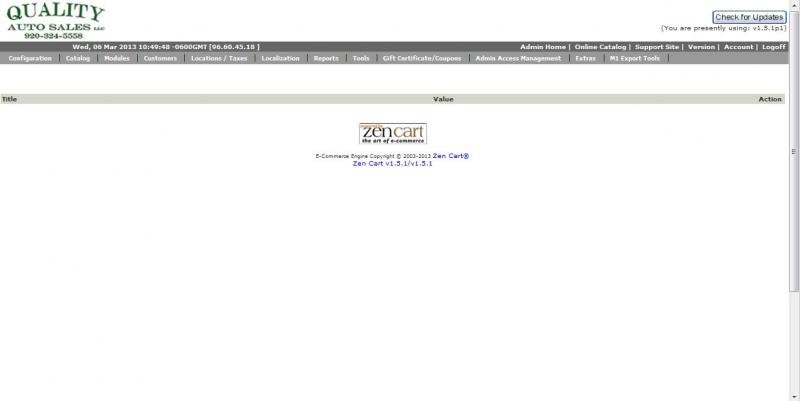

Well I have read somewhere on this forum that Zen Lightbox may cause problem's with this module. Anyway I did fix the issue with the double slash, which is caused by Hostgator automatic Zen Cart set up. As far as the install I have checked a few different times. The only problem I see that maybe causing a problem is in the admin section under configuration Ceon Uri Mapping that page looks like this picture. See I did install this module then I unistalled this mod and I think that is why it's not showing any information on that page. I'm kinda stuck and would really like to get this module working. I do appreciate your help. I would be willing to pm ftp information so you can check to see any problem's that maybe happening. If you are ok with that.

Originally Posted by GodfatherAntiques;1190887The only problem I see that maybe causing a problem is in the admin section under configuration Ceon Uri Mapping that page looks like this picture. See I did install this module then I unistalled this mod and I think that is why it's not showing any information on that page. I'm kinda stuck and would really like to get this module working. I do appreciate your help. I would be willing to pm ftp information so you can check to see any problem's that maybe happening. If you are ok with that.

Your screenprint only indicates that the module is installed incorrectly which would explain why you are having issues.. If you've made a backup of your site prior to installing this (as is the recommended course), I suggest rolling back and starting over with installing this module..
