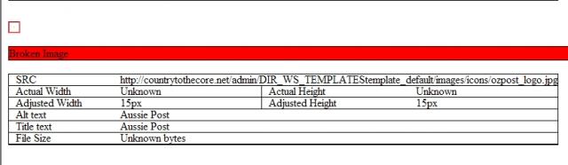

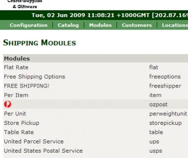

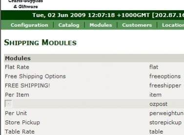

4 Attachment(s)
Re: ozpost shipping module
RodG
I assume that this is during the checkout process (rather than in the admin sections)?
No, what I was refering to is in the admin.
(see green bar and list jpgs)
Attachment 5836
Attachment 5837
As mentioned above, this change was for more than just cosmetic reasons. In that particular location it isn't an issue, but the same data also gets inserted into the orders tables, and the combination of text and the icon string can be too long for the database to properly handle.
In that case I can certainly do without them.
The icons in /admin/includes/ ... etc were only a copy of the icons under /includes/, and really shouldn't be needed with 'ozpost' because they are supposed to be disabled for the admin functions of the store.
I really can't explain they they are even attempting to show with your setup.
I'll make a guess here, I removed the auspost files via FTP, then upload ozpost files, THEN went to admin to turn it on and configure. Perhaps if I had started at adim and removed auspost via the button there, then FTP'd then back to admin and swithched on the new one.
This is why I'm making that quess: Today I again removed all ozpost files and reloaded. After went to admin and it was already "on" (no install button) I removed it (via the button) then had the install button. After installing, things looked differant this time. No red square withX and no alt text, but I do get an empty square. (see green bar after and list after jpgs)
Attachment 5838Attachment 5839
Hi Rod, Here is the image report.
It might help you figure out whats going, it might just be my set up.
Attachment 5840
David
australican
David
I'm not going to say it has helped me figure it out (well, maybe it has), but I'm now pretty sure that this has something to do with your setup.
Attachment 5841
Note my highlighting in the image above.
Firstly, the "DIR_WS_TEMPLATES" text shouldn't be presented to the client, this is supposed to be a defined constant containing the actual path to your template directory.
Secondly, it appears the reason it is showing the constant rather than the path is because there appears to be a missing slash "/" between this constant, and the text path "template_default". In other words, rather than
/DIR_WS_TEMPLATESemplate_default/
it should be
/DIR_WS_TEMPLATES/template_default/
And if it were /DIR_WS_TEMPLATES/template_default/ the DIR_WS_TEMPLATES would be an actual path string, so the client would actually be looking for the icon in
/your/template/path/template_default/
I'm going to go out on a limb here and suggest that if you check your configuration file /includes/configure.php at or around line 35 you will find you are missing the slash at the end of the path definition.
I'm actually a little surprised that this error hasn't caused you other issues above and beyond the ozpost module.
lemee know if my guess is right or not.
