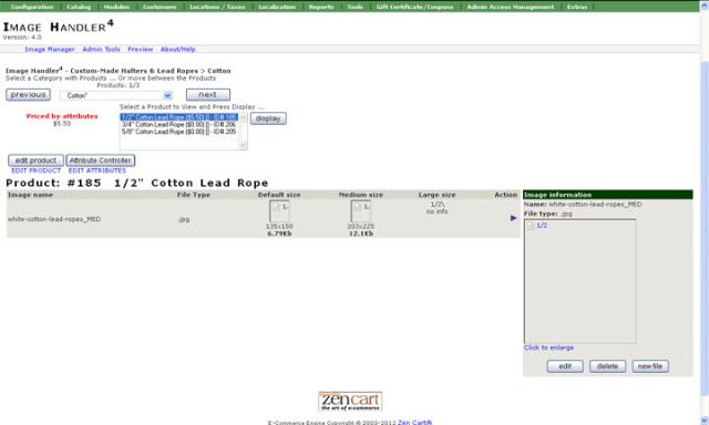

Just did a new install of IH 4. Everything seems to be working with images appearing in online catalog but the little image previews are not appearing on the Admin Image Handler.
Attachment 10345
Attachment 10345
