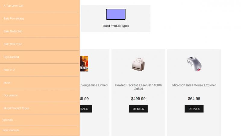

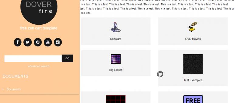

Also, I would like to edit and use define main page but when I do, (after disabling the slideshow) anything I enter into the main page is set off to the left of the page underneath the menu.
This also happens when I setup layout settings to display categories on main page.
Here are a couple of pics (I'm still messing with the color scheme so please disregard) that illustrate the problem:
Attachment 14454
Attachment 14455
What would I need to change to get both the main page as defined in define main page and categories on main page to display correctly?

Yes, that is the code to remove.
Since I have not added any css for the define main page content or main page categories, you will have to add these styles. If you post a link to your site I can take a look.
