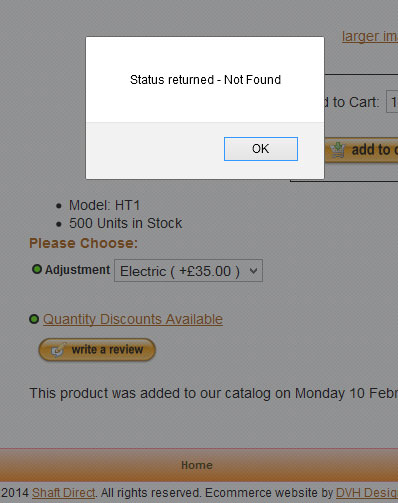

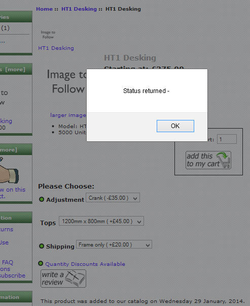

I installed this it on a fresh install of 1.5.1, and when I click on any product on I get the rotating gif both under price and in the side box.
I installed:
dpu_ajax.php (installed at root)
includes/classes/dynamic_price_updater.php
includes/modules/pages/product_info/jscript_ajax_updater.php
And per readme.txt no other modification is necessary. What is wrong
As I click on options i get the "Status returned - Not Found" error.

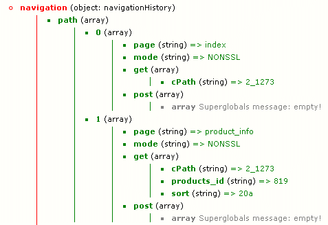

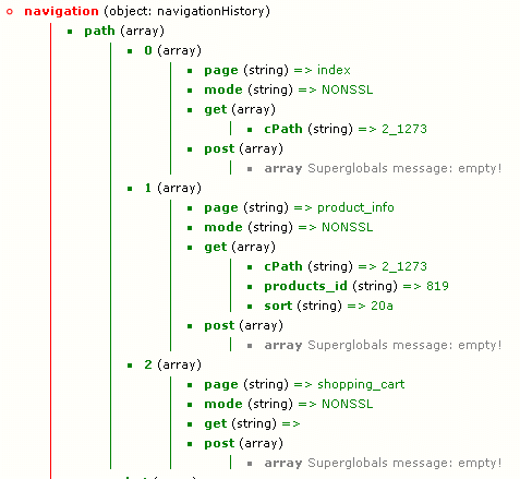

This is easier if superglobals is used to show the session variable only.
Scenario
Not logged in.
Go to a product and add it to the cart.
Go to another category and then a product.
The session, navigation object will contain two or three entries, but the last one has the current product_info page and id, and the second-to-last entry the category path as shown below.
Attachment 13287
Now go to the shopping cart.
The “Back to Shopping” button is not linking to the last product but to the index page and the navigation object shows why: the information is gone.
This is what is in the object.
Attachment 13288
This is what should be in the object.
Attachment 13289
What wipes it is the call to application_top.php made in dpu_ajax.php

I have upgraded our current site from 1.3.9h to 1.5.1 on our test server followed by a fresh install of Dynamic Price Updater (this is the first time we have added DNU)
however, now I am getting the Status returned - Not found window as attached
Attachment 13767
I have read past threads that suggest a SEO redirect might be an issue, however, this particular add-on was removed during the upgrade - we have checked and there are no files remaining from this add-on.
I am running Stock By Attributes: Are there any known conflicts with this Add-on? Please could anyone advise.
OK There are two threads running for support on Dynamic Price Updater. Please could someone enlighten me if I am on the right on or not? Then at least I don't get into trouble for duplicating posts.
Ok, I have restored my website to how it was after I upgraded form 1.3.9h to 1.5.1. I have added the Dynamic Price Updater add-on again and this time, instead of the Status - Not found window popping up as soon as I visit the page, now it at least waits for me to select an attribute before coming up with the same.
The way these tests are going, it's looking like I am having to download and install 1.5.1 add the Dynamic Price Updater and then build the site around that. Not ideal but I may not have a choice. :no:
If anyone on the forum could help me out then I will make a generous donation. Good to my word. :please:
PM'd to you. it's not my actual site but a test one that should demonstrate the issue
Thanks so much ;)
And I got it working on my local XAMPP server, came to upload it and it doesn't work on my normal server (http://212.113.133.235/~shaftltd/)
:cry: Please could anyone help or offer some advice?
That was exactly the problem. I have loaded it onto a folder off the live server and both DPU and SBA works works works! :jump:Attachment 13811

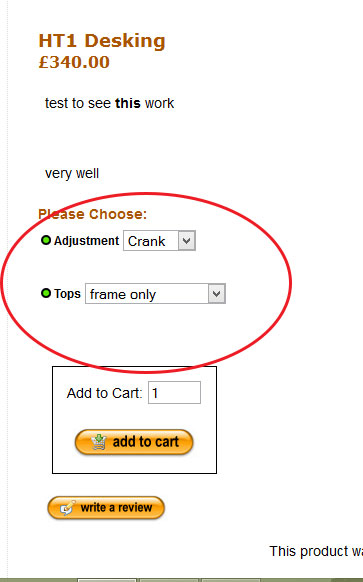

One trivial thing: the top attribute is selected as default (attached) is there a way we can change this so the user has to select an option? Eg the top field reading Please select or something? Please advise.
All works fine. One last thing: I have the total show up twice on the page, is there a way I can change this so the Unit price for the product shows up as well as the total?
