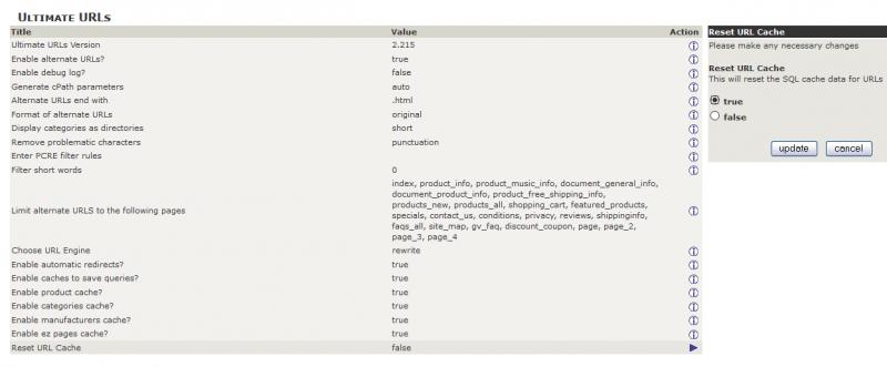

Attachment 16779
This is my settings.

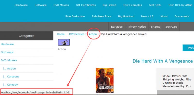

Thanks carlwhat, i have already fixed the first issue, now I can access to admin page now. i just posted another problem on post #1089, any ideas?
Re: Ultimate SEO 2.200 [Support Thread]
ideas? sure... i would still turn strict mode off...
with regards to your new problem, what template are you using?
your problem is NOT related to your .htaccess file.
some script is creating those links; and that script is ignoring the setting for your URLs.
good luck.

i just use the default Responsive Classic Template.
Attachment 16780
i also tried Classic Contemporary Green, still the same
that is a breadcrumb. it is constructed here:
includes/init_includes/init_add_crumbs.php
you can then see where the category part is constructed. my code looks like:
$breadcrumb->add($categories->fields['categories_name'], zen_href_link(FILENAME_DEFAULT, 'cPath=' . implode('_', array_slice($cPath_array, 0, ($i+1)))));
you then would need to find zen_href_link which i see here:
includes/functions/html_output.php
mine modified looks something like this:
function zen_href_link($page = '', $parameters = '', $connection = 'NONSSL', $add_session_id = true, $search_engine_safe = true, $static = false, $use_dir_ws_catalog = true) {
global $seo_urls;
$href_link = null;
if(isset($seo_urls)) {
$href_link = $seo_urls->href_link($page, $parameters, $connection, $add_session_id, $static, $use_dir_ws_catalog);
if($href_link === null) {
$href_link = original_zen_href_link($page, $parameters, $connection, $add_session_id, $search_engine_safe, $static, $use_dir_ws_catalog);
return $href_link;
good luck!
Thanks carlwhat.
For includes/init_includes/init_add_crumbs.php, my code is the same as yours.
For includes/functions/html_output.php, mine is different:
global $request_type, $session_started, $http_domain, $https_domain, $zco_notifier;
$link = null;
$zco_notifier->notify('NOTIFY_SEFU_INTERCEPT', array(), $link, $page, $parameters, $connection, $add_session_id, $static, $use_dir_ws_catalog);
if($link !== null) return $link;
if (!zen_not_null($page)) {
die('</td></tr></table></td></tr></table><br /><br /><strong class="note">Error!<br /><br />Unable to determine the page link!</strong><br /><br /><!--' . $page . '<br />' . $parameters . ' -->');
you need to look at the README in the install.
my version is slightly older.
look under modified files. you have not done that part.
global $request_type, $session_started, $http_domain, $https_domain;
// START alternative URLs patch
global $altURLs;
$link = null;
if(isset($altURLs)) {
$link = $altURLs->href_link($page, $parameters, $connection, $add_session_id, $static, $use_dir_ws_catalog);
// END alternative URLs patch
Thanks again carlwhat.
I replaced the code with yours, now the site works well now. Currently all my problems solved, i really appreciate your help, have a nice day.
