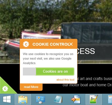

Still battling on here - on my own too it seems :dontgetit
The attached image shows the pop-up box when the corner banner is clicked. The text, certainly the box title, is a tad too large, such that it runs into the box closer (X). I am having difficulty (again...) finding the appropriate setting to change this ? Plus of course the issues above.
Attachment 15067
Mike
