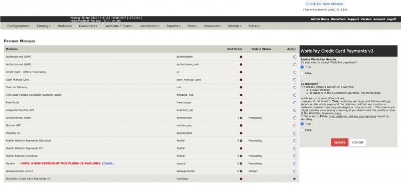

Well I have it sort of loaded, but I don't see all the options for entering WorldPay details correctly.
Attachment 18955
