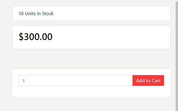

Hi, before I start tearing my hair out on this one minor detail, is this normal? Referring to the blank cell between QTY and Product Name.
https://i.imgur.com/uqt1en9.png
I noticed in the code there is still a reference to a checkbox to delete but noticed that it doesn't even pop up in Classic Contemporary Green?
Using ZCA 3.6.1 on ZenCart 1.5.8 on PHP 8.2.

Welcome to the forum. You will get quicker responses if you post your query in the support thread for the particular product/service. In this case, https://www.zen-cart.com/showthread....strap-Template.
Also, the answers to the posting tips really help. Things like versions, PHP, mods, customizations, etc are bits of information that speed up the process.
Meanwhile, the reset (circling arrows) that shows up under your quantity should be in the blank cell you are concerned about. Without seeing the site, I can't really guess as to why.
Unless your site is on a local setting, you can provide the link as yoursiteDOTcom and we can take a look.

I'm not sure what the question here is, but if you're using the Bootstrap template what does that have to do with the "Classic Contemporary Green" one? Templates are a one-or-the-other choice.
I reverted back to using Classic Contemporary Green to compare what's different between ZCA Bootstrap 3.6.1 (which is the one that was installed, not sure if that was clear) and the Classic Contemporary (which is pre-installed with ZC). Was generally trying to remove the blank space that was present.
I'm 90% sure I found the answer to my original inquiry on my own though after your original post. But thanks anyway.
This installation was done locally. So there is no address for me to share unfortunately.

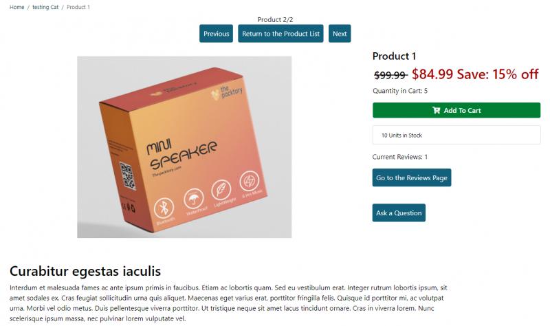

Hi there,
Once again, loving the template.
I would like to know if anyone here can help me with the following.
I am looking for an easy way to swap the normal price and the special price, perhaps move them to separate lines.
I will attach two images, first is how it is now and the second is what I am trying to achieve.
Attachment 20477 Attachment 20478
Thanks in advance for any help/suggestions
*edit: Without having to fiddle to much in ZcaBootstrapObserver.php

Looks like a small addition to the site's /includes/templates/your-bootstrap/css/site_specific_styles.php will do the trick, adding:
.normalprice { float: right; }
Re: ZCA Bootstrap Template
HAHAHAHAHAHA you can tell it has been a long day when you miss something as simple as that.
Thank you lat9, worked like a charm.

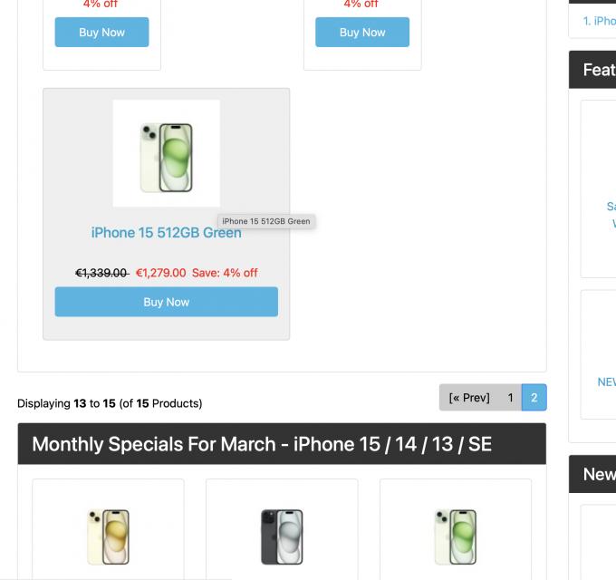

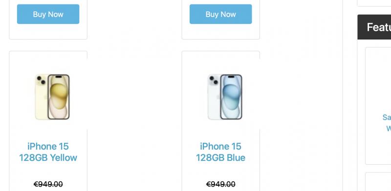

Hi all,
I'm still working on implementing an updated website using bootstrap template. I recently updated my BS version from 3.6 to 3.6.3 by updating the changed files in the readme docs. Using ZC 1.5.8a. In testing my site, I'm coming across a couple of minor issues I'm hoping someone can help me address:
1) In small screen media mode <576px the category column is limited to 32.5%. I think this is because I have columns per row set to 3. When I change to 1 the mobile display is fine, but the desktop display has more columns than I want. How can I have 1 column in mobile mode and 3 columns in desktop mode but still remain fluid based on screen width?
2) The back-to-top button continues to appear on top of other buttons, despite the fix that was supposed to be added to 3.6.3? Couldn't find where to disable the button or adjust settings. It's mainly affecting the checkout button and confirm order buttons. Maybe I missed something when updating the template?
Thank you in advance!
1) Did you try changing the columns-per-row to 0 (fluid)? If that doesn't do what you want, v3.6.3 adds a 'soft' configuration setting:
// Starting with v3.6.3, a categories' fluid layout can be identified. If predefined (like
// in an /extra_datafiles .php module), that override is used.
if ($category_row_layout_style === 'fluid') {
$grid_cards_classes = 'row-cols-1 row-cols-md-2 row-cols-lg-2 row-cols-xl-3';
if (!isset($grid_category_classes_matrix)) {
// this array is intentionally in reverse order, with largest index first
$grid_category_classes_matrix = [
'12' => 'row-cols-1 row-cols-sm-2 row-cols-md-3 row-cols-lg-4 row-cols-xl-6',
'10' => 'row-cols-1 row-cols-md-2 row-cols-lg-4 row-cols-xl-5',
'9' => 'row-cols-1 row-cols-md-3 row-cols-lg-4 row-cols-xl-5',
'8' => 'row-cols-1 row-cols-md-2 row-cols-lg-3 row-cols-xl-4',
'6' => 'row-cols-1 row-cols-md-2 row-cols-lg-2 row-cols-xl-3',
2) There's a 'soft' setting (see dist.site-specific-bootstrap-settings.php) that totally disabled the back-to-top button. If you still want it to show, but not overlay "important" buttons, here's what I added to my /css/site_specific_styles.php so it overlays the footer:
#back-to-top {
bottom: 2.5vh;

Thanks, Lat! I have a 3/9/0 column setup with the template, so I changed the 4,5 and 6 on the configuration all to 3 and now it displays correctly on the smaller screens and has a max of 3 columns on larger screens. Is there any way to get the categories to fill the width of the center box equally on the larger screens though? For example, when I have column count set at 3 and there is a row with only 2 categories, they auto adjust to 50%. When I change the column count to 0 for fluid, now each category only takes up 33%, even if there are only 2 categories on a row. Just a visual preference, not a dealbreaker, but wanted to check.
2) I added the code you provided to the css (as well as my separate css file called by the site-specific version) and no change on the back to top button--it still overlays checkout and confirm order. Anything else I can look at?
1) That's the way that Bootstrap card-deck elements work.
2) A link to the site?
Again using 3.6.3 ZCA and ZenCart 1.5.8s on PHP 8.2.
I am getting the following display of the product price when displaying a product with attributes assigned.
https://i.imgur.com/SGvTfMk.png
Should I manually remove one of these price blocks or is there a way to toggle which one is displayed? (For note, this is the default product type with attributes.)
You'll need to either edit your tpl_product_info_display.php to comment-out either the upper or lower price display or provide styling (in the /css/site_specific_styles.php) to do a display: none; on one of them.
#back-to-top {
bottom: 2.5vh;
Hi Cindy,
On 1.5.7d with 3.6.3 the the columns-per-row to 0 (fluid) is not working as per attached image. Is this something that changed in the latest version or is something I am doing wrong?
Attachment 20517
Hi Guys,
In 1.5.7d and 3.6.3 the Listing Columns Per Row and the Listing Layout Style in product listing, do not have any effect when changed. I this a change in the version 3.6.3 or I should reinstall the template? see attached photos
Attachment 20518Attachment 20519Attachment 20520
