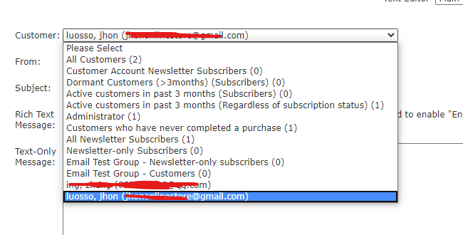

Under 'Tools -> Send Email' you'll see new customer groups:
Email Test Group - Customers
Email Test Group - Newsletter-only subscribers
These two fields pull the correct emails you designated in your
Newsletter Test Group Email settings.
Newsletter Subscribers
Customer Account Newsletter Subscribers
Newsletter-only Subscribers

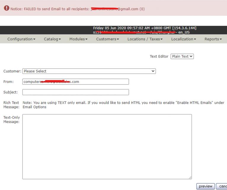

I don't see new customer groups or Newsletter Subscribers under 'Tools -> Send Email'.
Rather, under Tools ->Send Email, it says:
"Send Email To Customers Text Editor
1267 Illegal mix of collations (latin1_general_ci,IMPLICIT) and (latin1_swedish_ci,IMPLICIT) for operation 'locate'
in:
[SELECT s.email_address as customers_email_address FROM subscribers as s LEFT JOIN configuration as q on LOCATE( s.email_address, q.configuration_value) >= 1 WHERE configuration_key = 'NEWSONLY_SUBSCRIPTION_TEST_GROUP' ]
If you were entering information, press the BACK button in your browser and re-check the information you had entered to be sure you left no blank fields."
What does this mean? Can someone please help? Thank you.

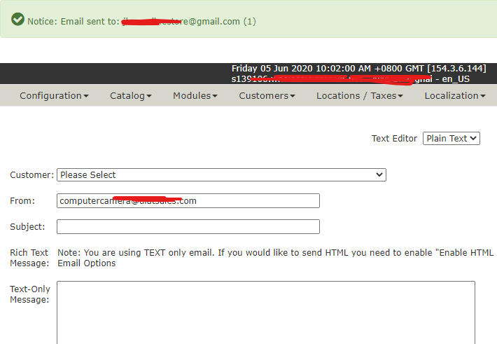

zen cart version:1.55f
newsletter_subscribe_3.0.2
Can't send mail
Attachment 19031
Attachment 19029
I try to close
Configuration -> My Store -> Enable Newsletter-only subscriptions? -> false
it's work
Attachment 19030
:blink:May I ask where the plugin is not set correctly?
