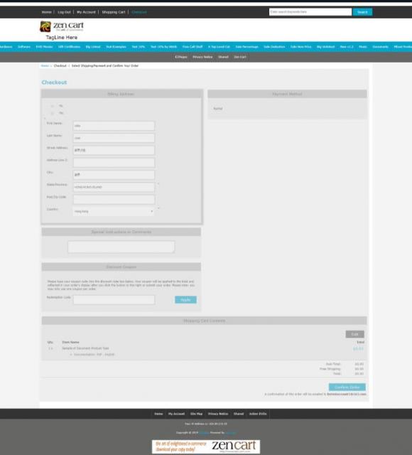

I am using the 1.55F version.
There is a problem with PayPal Express Payment.
But click on the PayPal page to confirm the payment back to the website, the page can not be clicked.
How do I need to modify it to fix this problem?
Attachment 18562

Which version of One Page Checkout is installed? What template are you using? Have you modified any of the OPC template files for use on your store?
one_page_checkout-2.0.5
Use adaptive templates
There have been many changes to OPC since v2.0.5 (the current version is v2.1.2). Noting that a couple of those changes have corrected interaction with the PayPal payment methods.
Can zencart 1.55F use the v2.1.2 version?
