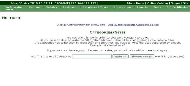

Attachment 7449
pls look into ths.....
only i can find ths in admin part/multisite
Attachment 7449
You've missed something when installing the multisite module. Go over the entire installation again and i'm sure you'll find what you've skipped. But, go over it MANUALLY, line by line as it says in the instructions included with the module.
Perhaps you installed some other addon after installing Multisite? That might be a problem, you know... But, go over the installation and you'll fix it for sure.
once again i installed the module with given instructions ...
while giving sitename in description, subcategories are displaying in front end.....but in that particular page i cant able to add categories to site......

I have problems with showing subcategories on category page in some cases.

1)I have seen other forums and check all the settings for the admin.
2)I use multisite module and I checked sites' relations

On the first link in your post, I do see one sub-category. A sub-category will not appear if it and EVERY parent category is not also defined as part of a site (defined in admin > tools > multisite tools > relations). So if you have a category with 3 sub-levels, each level must be defined as being a part of the site you want it to appear in. I suppose also, in admin there is a setting to not show categories that have no products? (config > layout settings)

3.) Point 3 in your original question contains similar code used in the multisite module used to define the categories for each site. Maybe its placement for the other module its used for is interfering with the multisite module, which also uses a HTML comment to distinguish categories?
