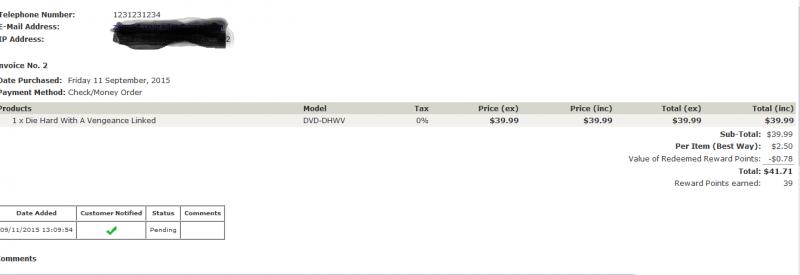

It is not doing as you are describing on the orders page. Works great, see screen shot I have uploaded. You will see it deducts points just fine.

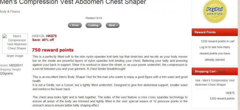

The product reward point display is correct:
Attachment 15634

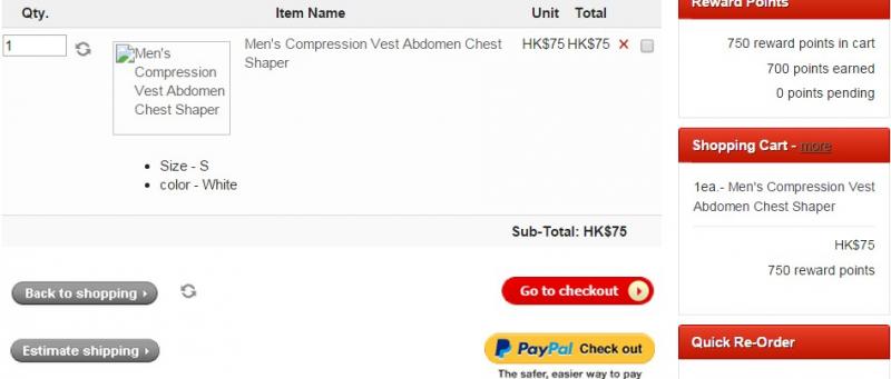

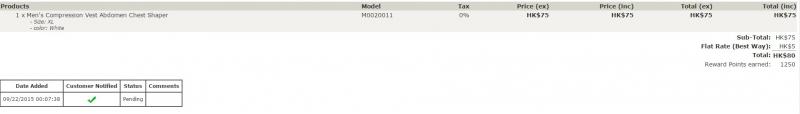

But when checkout, the reward point calculated based on original price, i.e. $125 instead of $75. As a result, it earns 1250 pt.
Attachment 15635

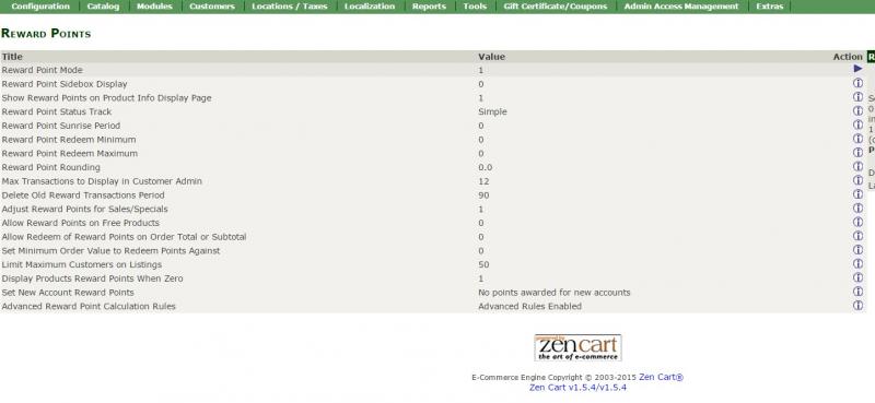

Here please find the config setting:
Attachment 15639

I installed the Reward Point Full Suite Module Version 25.e on ZenCart 1.5.4 and I have two issues one is I am unable to switch the Reward Point Status Track from Simple to Advanced so I can customize the order status I want for the points to be transferred.
I do not have any debug logs for this issue and I have looked through the MYSQL to see how I could change it to Advanced. I am able to change the value in the database from 0 to 1 so the configuration will show it is in the advanced mode, however I am still unable to select my preferred order status such as “Delivered” or “Completed”.
Is there any way I could modify the code or my database so I can switch the Reward Point Status Track from Simple to Advanced?

I have reward Points installed on a stock zen cart 1.5.4. When selecting The Reward Point Status Track,
Advance mode works just fine when switching between simple and Advance with no problem what so ever. Go back recheck to see if all files uploaded to there right place on your sever. You shouldn't have to do anything to the sql statement to get it to work. Uninstall the sql statement and reinstall it to see if that fixes it. Always make a backup of your database before dong any module installations. That way if something goes wrong you have the old backup right?
