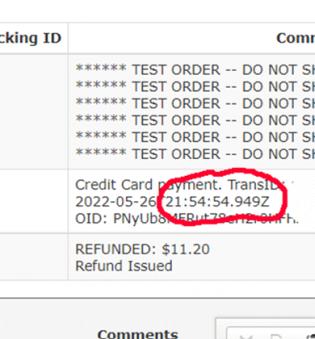

More information on the subject.
Made sure I was the only one processing an order and monitored from cart addition to completed charge with the chrome console.
The error log created was
[26-May-2022 21:54:53 UTC] PHP Notice: missing token result: check if card button is disabled on dev console using: document.getElementById('card-button'); else look for javascript error in console. in /includes/modules/payment/square_webPay.php on line 234
Yet, the successful transaction was made one second later.
Attachment 20012
So, if I am getting this result correctly, we have situations where the bank okays and ZC doesn't AND (in this case) the process worked despite the missing token.:dontgetit

i have been to said site and everything operated correctly as far as square looks.
the error message indicates that the payment form was submitted, but the response from square was not on the form. any time you see line 234 in v1.0.1, that means the post of the form to your ZC server does NOT have any response from square.
it does NOT mean you submitted a transaction, although you may/probably/most definitely (pick one) might have. looking at your square dashboard will tell you if you have. the error message means that if there was a response, it was not on the form and therefore ZC can not do anything with it because it does not know anything about it.
this is the essence of the problem with OPC that was resolved with the changes made (and implemented on said site) with regards to OPC.
if you are getting the error and then everything works properly a second later, you are most likely having a javascript problem. 2 event listeners are submitting the same form one after the other would be 1 guess.
you are having other javascript errors on said site, which may cascade down to your problem. but in my latest review, everything looked fine to me. and the response from square was on the form. and i got an appropriate error:
Your transaction failed due to an error: [PAN_FAILURE] Authorization error: 'PAN_FAILURE'
that error comes from square.

Unfortunately, I have no access to the Square Dashboard.
I've sepent the day trying to find any javascipt error elsewhere. And, I had done that transaction in down for maintenance with only my IP as allowed.
Watched the console through the whole process with no problems noted yet got the token notice one second before the success notice.
I suspected older mods like Products with Attributes Stocck and Numinix Product Fields but can't find any evidence that they are the culprits.
If you have any advice as to where else I might look, it would be greatly appreciated.
