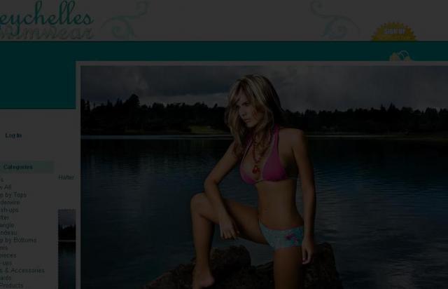

A new user here, we have a new zencart that has been implemented and i installed he zen lightbox yesterday. Works like a charm, however i have 1 issue, that perhaps someone could shed some light
1- If my product has no attributes defined, the lighbox works fine. ex here
2- However if my product has attributes defined, the image still opens up in a pop up. Ex here
We use the same product image for the attributes but for some reason the lighbox wont be triggered for these products.
Please any suggestions would be great

I just upgraded to 1.5, I am still having the same issue where images which have an attribute defined are still opening up in a popup, ones that are without the Attributes open just fine in a Light Box. I hope the contributor on this feature can help me out..
