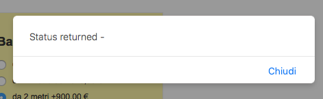

by doing local tests I noticed that on some products I get this kind of warning
Attachment 17264
Attachment 17264
Based on the above, I have to ask why have you either disabled zcJS or modified the DPU code not to use it although it has been recommended by the core developers to use zcJS and at least the associated ajax.php file?

So a couple of things. On my side, I apologize to all for assuming that the site in question was a ZC 1.5.5e site based on the current tagline which states so. (future readers, this tag line may be different and therefore any posts by the OP stating to see the tagline should be taken with a grain of salt). Secondly for not asking directly which version was involved.
That said, ZC 1.5.4 comes with the same or similar jscript_framework.php file as in ZC 1.5.5 in the folder includes/templates/template_default/jscript. That file, when incorporated with the current template will provide zcJS which is preferred over the included/legacy XHR that was kept with this plugin for compatibility and potential of others having built on it.
Also, it was pointed out aboutthe jquery file not being included (whether in whole or by "reference". Looking through the file structure, it is not present as identified, though there was a bit of a language barrier issue/misinterpretation on my part. I thought the concern was not having provided the referenced file. The concern was that there was nothing that ensured that jquery (or rather javascript) was loaded.
So, from that short discussion there are improvements available to be made to the instruction to cover these two topics and possible an "alternate" folder to provide the loading of jquery if something is not there already.
So, on the issue of the pop up message. It occurs when zcJS is not used, the enquiry to the system is complete and the status response is not 200. It could be a response of no change or some other result. To identify, would suggest monitoring the network traffic through the browser and noting the response that occurs when that message is presented. It may be something to "catch".

DPU is installed both in zencart 1.5.4 and in zencart 1.5.5 as in the signature, the problems are identical on the two distributions of zencart 1.5.5 and 1.5.4, I also noticed that if there are no attributes the price remains zero . someone can tell me if he has installed DPU and that he has no problems I can give me a link. I also do the prose both locally and online when I can for a few seconds and the errors are both local and online.
