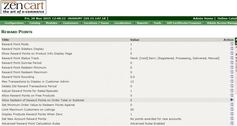

I just installed Rewards Points Suite v2.5 on out Zen Cart 1.51. It appears to work as advertised except all points are pending and I want them to be awarded immediately.
Sunrise = 0
Status Track I have set to Advanced Pend: [Void] Earn: [Registered, Processing, Delivered, Manual] all others ignore.
The store is for registrations so we seldom CHANGE a status. Default is Registered. Maybe that is the problem?
Is there a way to have points go directly to AWARDED status?
Here is my config:
Attachment 15812

osulywan
Sunrise = 0
Here is my config:
Attachment 15812
I came here to ask the same thing. I have hit the same issue.

lindasdd
I came here to ask the same thing. I have hit the same issue (pending points not moving to Earned.)
A quick fix is to run the following SQL in the admin SQL patch page whenever you want to transfer all of them:
UPDATE reward_customer_points SET reward_points = (reward_points+pending_points),pending_points = 0;
