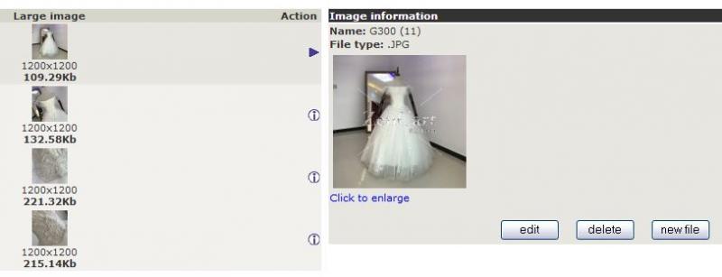

Hi I have a new installation currently running on xampp and installed the latest image handler. I created a test product with 4 images (see image):
Attachment 18148

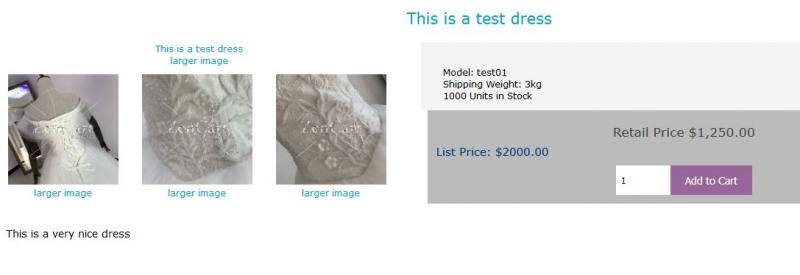

But on my product page the main image is not showing (see image):
Attachment 18149

@Goshawk, did you merge/update your store's template directory to make the IH-required changes to /includes/modules/YOUR_TEMPLATE/main_product_image.php?
Yes I have,

I found the problem:
Believe it or not, it was related to includes/configure.php
I manually set the parameters inside the config file and here is the wrong code:
When I removed the forward slashes the problem disappeared. I noticed that the url was localhost/shop//page......Code:define('DIR_WS_CATALOG', '/');
Just thought I post my error here just in case someone else has the same problem.
Goshawk
Actually it would be the extra slash you have at the end of HTTP_SERVER and/or HTTPS_SERVER.
DIR_WS_CATALOG should always end with a slash which means that if it exists on its own, that it is a slash. Also possible that DIR_WS_IMAGES begins with an extra slash, but less likely for it to be there.
The idea is that a URI that perhaps did not need to be https:// would be generated by:
HTTP_SERVER . DIR_WS_CATALOG . DIR_WS_IMAGES . 'filename.jpg'
