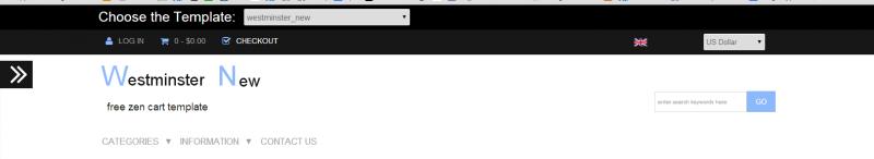

hi... i want copy only header from (westmister_new) to this template please help .. i want add this header to this template Attachment 14149 (this header From westmister_new template )
